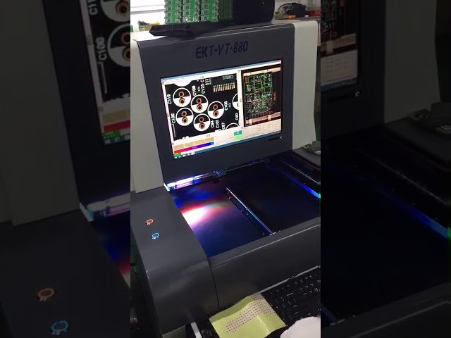

EKT AOI machine application: inspection after stencil printing, pre/post reflow oven, pre/post wave soldering?FPC etc. Stencil printing: Solder unavailability, insufficient or excessive solder, solder misalignment, bridging, stain, scratch etc. Compo
