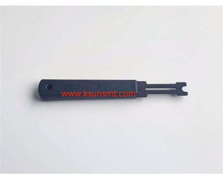

KV8-M88E1-00X 0.8 E-RING FOR YAMAHA TOOLS More information about Products please Contact US at jenny@ksunsmt.com or visit www.ksunsmt.com
