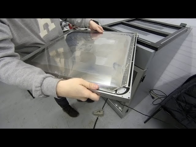

Universal stencil frame F584
External dimensions: F584: 584x584mm F584L: 736x736mm Inner dimensions: F584: 508x508mm F584L: 508x508mm Frame mechanism: anodized aluminum whole frame (not welded from 4 parts) with the possibility of compression-extension of the spri
