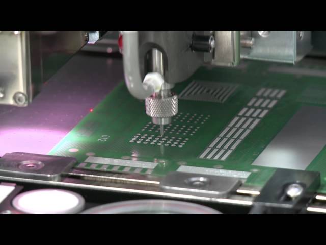

Spectrum II - Solder Paste Dots & Lines
With the Spectrum II's new Precision Z-axis, smaller dots and thinner solder paste lines can be achieved. This capability is standard on all Spectrum II systems and replaces the Precision Z option on the older Axiom products. In order to achieve su
