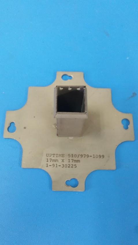

Hot Air BGA Rework Nozzle for the SRT BGA Rework Station 17 X 17mm
SRT, VJE, VJ Electronics BGA Rework Nozzles 17mm x 17mm Hot Air Nozzle.  Fits SRT Sierra Summit, 1000, 1100 , VJ Electronics and more.
