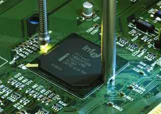

The bench-top industrial endoscope provides direct visual inspection of the solder balls on the underside of mounted area array components.
The endoscope shown in Figure 2 features a bench-top stand consisting of an X/Y platform and an adjustable head with two vertical probes: a fiber-optic light source and the scope itself. The scope is an optical instrument with a prism and more than 30 internal lenses providing up to 350X magnification. The prism enables a 90� view of the underside of the component. Connected to the scope and mounted in the head is a CCD color camera, which enables projection of the images seen by the scope onto a flat screen monitor.
Figure 3
Figure 3
In inspecting an area array component, the fiber-optic probe is lowered to the gap area between the package and the substrate on the opposite side of the component from the scope.
Figure 3 indicates how the inspection stand works. To examine a BGA, for instance, the fiber-optic probe is lowered to the gap area between the package and the substrate on the opposite side of the component from where the magnifier scope is to perform the inspection. The scope is then positioned for scanning along the edge of the component, and images are then viewed directly on the monitor.

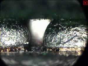

Interior solder balls can be viewed by positioning the scope, as necessary, along the four edges of the component, with the fiber-optic light source being located on the opposite edge to provide the required illumination.
The depth of field can be adjusted to examine solder balls further in from the periphery of the component. These balls can be seen from different angles (Figure 4) by moving the scope along the four edges of the device, provided that the fiber-optic light source is positioned on the opposite edge of the component. By manipulating the probes, the shape and surface condition of the interior solder balls can be effectively inspected for defects.
Figure 5
Figure 5
By adjusting the depth of field for the scope, individual interior solder balls can be clearly seen.

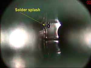

Solder splash - a defect example.
Figure 6 depicts various conditions that may be seen with the endoscope. Such defects could not have been seen with the most advanced AOI systems and would also likely escape detection even with X-ray equipment. (The X-ray system may suggest a suspicious condition of some kind, but the endoscope will actually show the defect, if one exists.)
