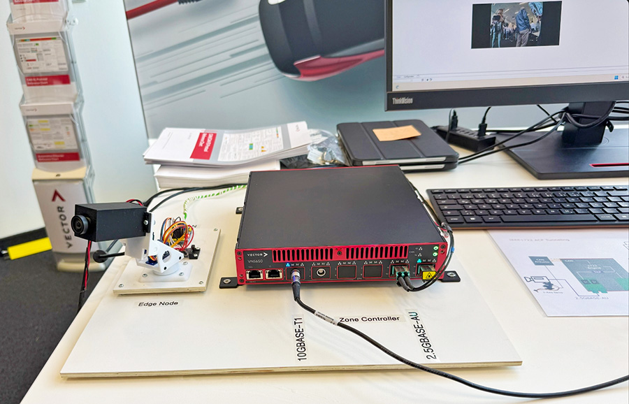

Demonstration setup: A VN5650 with integrated KD's optical KD7251 PHYs is shown with its optical connectors. In the setup, the PHYs are looped to transfer gigabit camera data live. (Copyright: Vector Informatik GmbH)

Vector, a long-standing partner in embedded electronics development and networking in automotive, has expanded the capabilities of its VN5650 Ethernet interface to include multi-gigabit optical Ethernet testing in compliance with IEEE Std 802.3cz-2023. By integrating KD7251 optical transceivers from Spanish semiconductor company KD, the VN5650 can establish, monitor and analyze in-vehicle optical Ethernet links within existing Vector workflows. This enhancement marks a significant step toward mainstream adoption of optical Ethernet in automotive validation, leveraging tools and software already trusted by OEMs and Tier-1 suppliers.
With KD7251 devices installed, the VN5650 maintains its characteristic robustness and modularity supporting up to 12 Automotive Ethernet ports via VNmodule60 slots, while adding nGBASE-AU optical connectivity for link speeds up to 10 Gbit/s (with 2.5/5/10 Gbit/s supported by KD7251). Users continue to benefit from VN5650 features such as synchronous monitoring and fault/load generation, now extended to optical links.
The solution integrates with CANoe option Ethernet, enabling engineers to script, simulate, and verify Ethernet behavior at scale while assessing conformance to 802.3cz across representative vehicle scenarios. The existing VNmodule60 ecosystem remains fully compatible, allowing teams to tailor physical layers to each test setup without altering established workflows.
