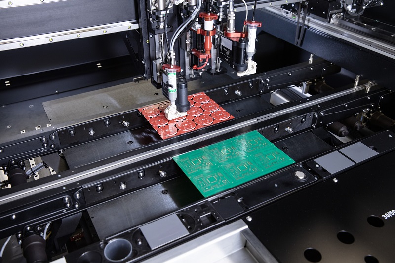

Essemtec proudly introduces the Tarantula Dual Lane, our most advanced dispensing platform designed to redefine flexibility, speed, and scalability in modern electronics production.
The new dual-lane architecture enables processing on two independent lanes. Built on Essemtec’s adaptive modular concept, the Tarantula Dual Lane supports up to three valve heads, making it the most versatile dispensing solution in its class.
With the ability to run up to 3 processes on a single platform, manufacturers benefit from simplified production lines, and a faster return on investment.
3 valves, 2 Lanes, 1 smarter Solution
Tarantula Dual Lane — Endless Versatility in Dispensing and Jetting
Performance Without Compromise
At the heart of the Tarantula Dual Lane lies Essemtec’s next-generation control and motion technology. With Jet-on-the-Fly, the system achieves up to 1.1 million dots per hour at maximum frequency, and an average of 350,000 dots per hour for complex boards in high-speed solder paste jetting.
For glue jetting applications, the Tarantula reaches a maximum frequency of 2 million dots per hour.
The platform supports up to three valves in parallel, offering full process flexibility—from solder paste to glue and epoxy jetting, thermal paste dispensing, or dam & fill applications. Whether used for fine-pitch solder paste deposits or staking, the Tarantula Dual Lane adapts precisely to your production requirements.
Versatility Without Limits
The Tarantula Dual Lane, along with other Essemtec dispensing platforms, is capable of jetting or dispensing almost any material used in modern electronic manufacturing and beyond.
Typical applications include dam & fill, 3D dispensing, jetting in cavities, staking, silver epoxy dispensing, shielding, microcoating, dielectric ink, liquid metal, thermal paste, and edge bonding.
The platform supports a wide board size range from 50 × 50 mm up to 560 × 500 mm, or identical board size up to 560 × 275 mm—offering true versatility for any production environment.
